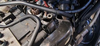

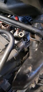

Hello Doc
On your image, No.3 is called "surge protection diode". This short cable/device is not fitted on my alternator. I totally get it this may now be incorporated into the regulator/rectifier mounted on the back of the alternator.
But after my earlier incident with sparks spontaneously eminating from the back of the alternator (actually I think it was the reg/rectifier) you'll forgive me wondering if there's a connection?!
See pics below. If you can discern the alternator through the clutter, you'll see the + cable is disconnected. But also you'll see no other cable... specifically the "surge protection diode" cable...

Hello Doc

Hohlee Schit I do not know Who The F*ck worked on your bike! But that is shoddy!!
So that cable lug should be on that threaded stud and an M6 washer and Nut (mine has a flanged washer / nut )
The picture is on my dismantled 1200
There is also a Multiplug that should be fitted on the empty port, and I think the alleged mechanic that was working on it should have removed the surge protection diode from the old alternator !!
But being honest I have not worked on TC very much at all so cannot be absolutely sure
Perhaps @nicholsonj2252 could confirm I believe he has had a couple ??
@Slipperyeel me Ole son !!
Well I found your Nut! How the hell you managed to get that all the way back just amazes me and yes you probably will see burn marks on the threaded bit or alternator casing!! :oops::oops::oops:
