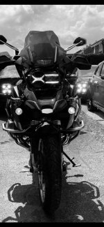

I use colights, £90 pair delivered Within 4-5 days. Brilliant. https://www.led-colight.com/products/colight®3inch-d-series-white-combo-beam-led-ditch-lightsIMG_1767.jpeg

I wired my colights through Denali ezcan along with sound bomb and rear light. So easy to fit and wire up. Love the way you can strobe spots when horn is activated.
