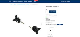

From Motorworks. https://www.motorworks.co.uk/windscreen-fitting-kit-faa94396-1.html
Sadly Pukmeidter, I don't mean the dome nuts.
IN the pic from Motorworks, the two handles for tightening the screen into position are on the right/hand side r/h/s of pic. I need the bolt/bush (which is threaded) immediately to the left of the two handles.
It may well be that I have to fork out the £116 for the set, but I'd rather not.

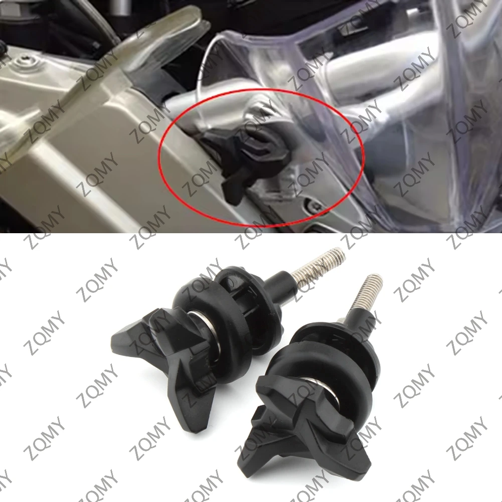

Hopefully, it looks like this!

Hi Charles, hope life is being kind to you, what about this kit from motorworks, is that not the "top hat" nut you are after?

Is the part not identifiable in online parts fiche such as RealOEM/MaxBMW?
It’s probably only a couple of quid each from BMW.
I think it’s item 5 of the windscreen support assembly
Part number: 46 63 7 676 996
Description: Bushing, Inside, M6
Brian, hello. Yes managing to stay the right side up. Hope you are well too, and life isn’t to outrageous to you.
Yes, thanks, that’s the part. But I have not yet found it on the Motorworks website. Thank you for making it a bit easier for me.
Pukmeister, thank you for this. Between yourself and Brian O, I am now aware of what I nee. I just kinda balked a bit at £116 price for the full kit on Motorworks. Cheers.
