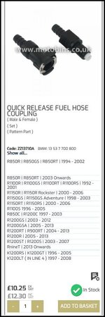

I bought two of the quick disconnects via Louis Motorrad (£59.01 delivered). They arrived swiftly and don’t seem bulky.
As suggested by Ser3J here,
Smoke from top of exhaust…. Thread​
They work great no problems…..

The Louis Moto ones I linked to are Metal and rated to 30 bar I think it said £30 a pair thats way cheaper than the E bay ones !!

Many thanks for all of your advice. I went with the Louis Moto metal QD and I am very impressed with the quality. Well worth the money. Service was spot-on from Louis Moto and I will get these agin for my RT at next service. As mentioned, the fuel clips are too big. 11 - 14mm from Halfords fitted perfectly.
