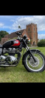

I put Hagons with remotes on mine, plus their progressive springs on the front, big improvementIMG_0246.jpeg
