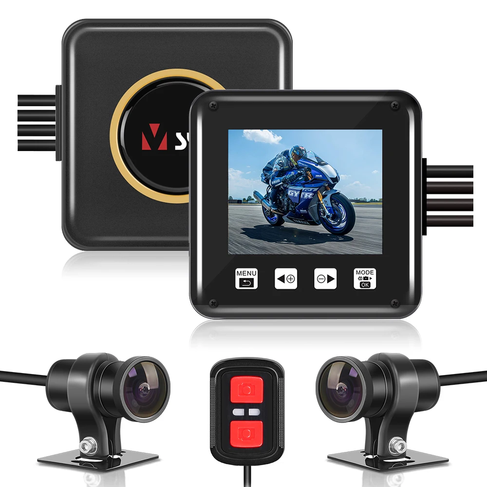

Have a look at this one, the cameras are quite small and it's the one I have on my bike
Just found this amazing item on AliExpress. Check it out!
£157.85 | VSYS P6F Pro F6X WiFi Motorcycle Camera Recorder Moto DVR With Parking Mode TPMS Dual 1080P Full Body Waterproof Motorbike Dash
That’s quite a big camera, I’d be looking for something more discreet and ‘hidden away’.
Thanks for all the other replies I’ll certainly take a look at those that have been mentioned :thumb2
It isn’t very big at all. I posted the wrong picture
Its big because the problem is the quality of the picture. Its just not possible to get a decent picture down a cable, thin enough. Hence why this 'camera' is bigger as there is no cable to push the picture down (front camera).
Its why you will find most systems have lower resolution on the rear camera than the front etc.
