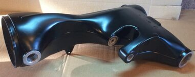

Results are in...
Thought it might be useful to finish this thread - Story so far is after much helpful support I took all my stripped out bits to Warren at Bristol Powder Coaters and we agreed a colour and price. Thought that was fair as the swing arm and gearbox case were very scabby. Few days later Warren phoned me to say he is having real trouble blasting off the original two part silver BMW finish on the gearbox and swing arm and he is justifiably concerned about pitting or damage to the materials and comes up with a couple of options. First is chemical stripping and the second is a hand paint prep and finish by a custom painter he recommended and deals with on a regular basis.
I initially contacted the strippers but to be honest they did not fill me with confidence, too long in the solution and my parts are useless and whilst they deal with car engine blocks etc., it was a side-line in a Lama wool production farm so I decided to give them a miss.
Enter into the scene, Ace from Ace of Sprays in Bristol. I have uploaded a few sample shots of the finished items. I decided to go for black even though the gearbox rebuild is on a silver original so I would know what was different to the bike…and to be honest just because I could. Plan is the gearbox, swing arm, torque bar and final drive will all be the same satin black finished by Ace.
Gearbox is currently with Steve Scriminger, will post a photo of the finished effect when it’s all done.

I had to heat and force (rubber mallet) the bush back into the torque bar this weekend and the paint stayed put during all that abuse so am hopeful. Thought a before picture might help?
