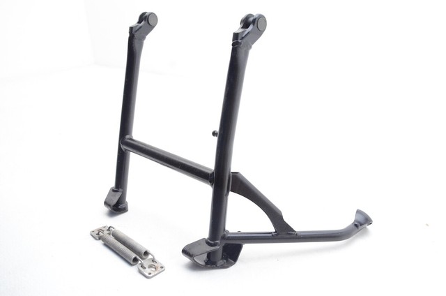

The stand on the LC has two prongs on each leg, and these each fit over a bushing welded into the frame bracket that the stand attaches to. When I had the stand off my GS, I couldn't see how I could use it as a lever as once the prongs are somewhere near their final position the stand cannot be tilted to get any leverage. I couldn't see any way of safely doing this.
GS LC stand:
I can imagine that if the stand had a single prong on each side like this then it could be a lot easier.

THe trick is to move the stand to the smallest angleand use the hook to pull the springs down,
the other way is to loop a wire trace round one end and hook onto that, you could then run the trace under the bar of the stand and use that as a crude fulcrum to use as a lever point to get the spring plate
attached.
Unfortunatly, sometimes brute force is your only option
Didn't realise the LC was forked - the hexhead wasn't. Can see why now...
Should be fairly straight forward looking at how its set up
Hook the springs on the bike at the upper point, and let them hang down. obtain a heavy duty fishing trace ( basiscally a length of thin steel cable with two loops or a loop and snap clasp on each end)
pass the trace under the crossbar, and attach to your springs - attach your T hook , steel bar, socket extension, - whatever you want to use as a handle on the other end.
Put your foot or both feet against the bar and pull on the trace, the springs will extend and can be snapped home.
Alternativly pass the trace wire through the welded loop on the frame to make removing the trace easier once the springs are fitted
