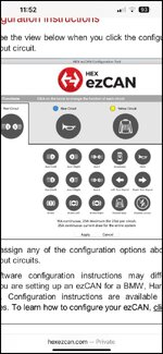

Guys sorry I meant this menu of choices , what have you picked from this page to put the drl's through as an accessory so the the ez can accepts them . Sorry for not making myself clear.
I used the one that says accessory 4th one along on the top row. It works for me.....

You could put the pair on the blue circuit, and configure from there , or one lamp on a circuit and configure from there
Unless the lights are designed to run on the white circuit, the only configuration is what's shown under the red blue yellow circuits
