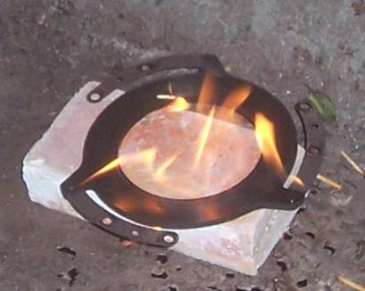

Clutch doesnt necessarily have to be replaced. I submerged my plates in benzene for about a day and then took it out and set it on fire to burn of any residue. Worked fine after that.
