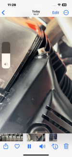

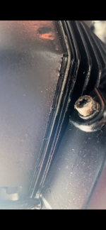

Well took again last night, the new cover is rocking very slightly. If I remove the spark plug rubber seal it fits perfect nice and snug. However with it installed and then the cover it just won’t seal.
Put the old cover on and it’s perfect.
Size wise they look exactly the same and measure the same. Internals look identical.
There are a couple of images I’ve taken from a video showing the difference, new one you can see oil start to seep.
I’m thinking of taking down slightly the circular ridge that the spark plug seal sits against
Doing my head in now..

It's hard to be sure looking at the pics, but on the replacement cover, the internal rebate setting the sparkplug aperture looks smaller than the original?
