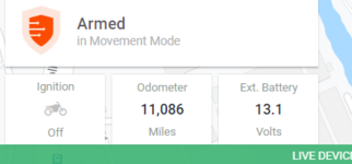

Will show you a screen shot later tonight and you will see power will be 12.5 this is normal according to Biketrac

Here is proof of Biketrac battery drain.
No it's not, it's only showing you what the battery voltage is.
If it drained 0.1v a day you'd very soon have a battery incapable of turning over the bike.
The drain from a Biketrac tiny, unless faulty.
If the first image was taken not long after a run the voltage will drop and settle a few hours later.
Here's mine, just taken after 2 hours or so sitting outside my office.
