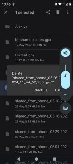

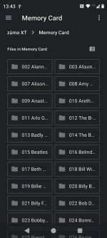

Well well! I tried and failed to connect the XT to either of my old Android Auto phones, a MotoG7 cast off from my wife and my old MotoG8 which run Android10 and Android11 respectively for the purposes of managing files on the unit which you can do with the older Garmin units. Today I connected my XT to a brand new Motorola Edge 40 Neo phone that my wife got me for my birthday......in hope rather than expectation! The new phone runs the latest Android14. Initially if did not look promising then suddenly this screen appeared.
Having subsequently timed it the screen appears 1 minute after the XT goes into charge mode on the new phone.
Looking at the USB status on the phone shows what it is doing.
You can navigate to the relevant files and delete them
and access the files on the memory card.
Dodgy musical taste :D
