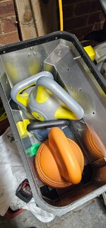

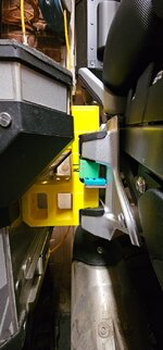

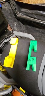

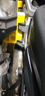

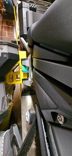

Seeing as the weather is crap and I'm a bit of a messed and an engineer of 44 years i thought I'd have have a go at making some mounts to fit my old (gs1200) panniers to the new bike, I've got a decent 3d printer , I've ordered so PA6 CF (CARBON FIBRE REINFORCED)filament, these are just cheap PLA to prove the concept.
I've got 25 kg in there and there not moving, just figuring out the latching system,
Keeps me out of the house anyway

yes there nearly ready, just got to print the final design, ive got some pa6 cf which is a carbon fiber reinforced nylon which is a strong as fook so ill be printing them out of that

carbon fibre reinforced nylon, not just plasick, is the same material that apduro use for there mounts for there panniers, this side looks abit convoluted is its the exhaust side, the other side are just flat , just the mounting points and a flat peice joining them together
Would that carbon filament need some fancy 3D printer as I wouldn’t imagine my Bamboo Labs mini would not cut it?
I've bambu p1s with a hardened .6 nozzle as recommend by bambu

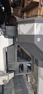

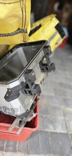

right nearly there just need to sort the fasteners out, the ones used are just for mock up, now printed in PA6 CF reinforced, they fit well are solid and are very strong712153098_3749389141870887_3896944665073339635_n.jpg689026787_3749389098537558_1124885902852173847_n.jpg710831963_3749389051870896_8046718043316771424_n.jpg710781928_3749389011870900_1137279525756761571_n.jpg710365915_3749388948537573_6240788475184212545_n.jpg710351772_3749388861870915_5693385701314335443_n.jpg710404522_3749388798537588_6793291220634812050_n.jpg

The mounts are of the same material that apduro make there's from, I've also had 50 kg in there for a week with no moment, it's not about the money if I wanted to id buy a new set op panniers I just have the equipment to make my own
