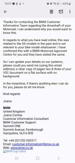

As we now know, the recall (service measure) to inspect and replace the drive shaft does not incluxe our RT models.Ive asked the dealer why not.Ask BMW sir.I asked them.Referred me back to the dealer.Familiar BMW customer service scam.Has anyone got an answer from them as to why the RT isnt included?

Not according to Motorrad UK.The e mail was from them in respose to my question wether or not the RT was included.
