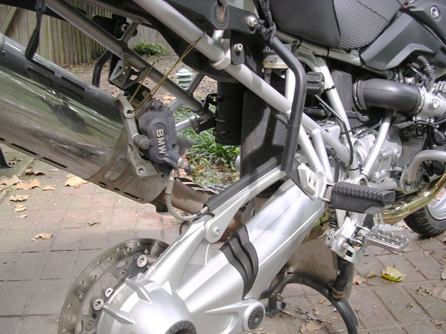

A tip when offering the drive up : use a long cable tie to hold the shaft up to the correct mating position .A hydraulic jack also useful to support the drive weight, but only for support ! Gentle coaxing and it'll mate easily, then cut the tie.

It isn't hard at all to pull the boot back with the FD in place. You will not get it very far, but you only need a small gap to check for water.
