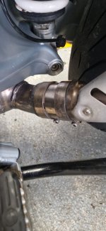

Hungrytang Member UKGSer Subscriber Joined May 23, 2012 Messages 18 Reaction score 1 Location Scarborough Sep 1, 2024 #1 I currently have a 2011 TC 1200gs and have the exhaust flat deleted. My question is would a can from an 04-09 SC fit my headers meaning I can remove the delete section.? Attachments 17251935239667949612375479227452.jpg 95.2 KB · Views: 27
vtr1000sp1 Active member UKGSer Subscriber Joined Jun 20, 2009 Messages 231 Reaction score 79 Location leeds Sep 2, 2024 #2 Hungrytang said: I currently have a 2011 TC 1200gs and have the exhaust flat deleted. My question is would a can from an 04-09 SC fit my headers meaning I can remove the delete section.? Click to expand... My understand is yes. Cans from pre flappy bikes will fit - they have a longer connection pipe meaning the delete section can be binned
seahorse Well-known member UKGSer Subscriber Joined May 5, 2011 Messages 1,401 Reaction score 372 Location St. Albans Sep 2, 2024 #3 Not sure that's the case. I replaced the headers with 04-09 decat ones so I could use the earlier type can. The flap has a larger diameter than the earlier type link pipe.

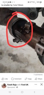

Hungrytang Member UKGSer Subscriber Joined May 23, 2012 Messages 18 Reaction score 1 Location Scarborough Sep 8, 2024 #4 Found an answer to my own question on Facebook 1cm diameter difference So if you want to fit 04-09 to a later bike you need early headers too Attachments Screenshot_20240908_084514_Facebook.jpg 64.3 KB · Views: 11
