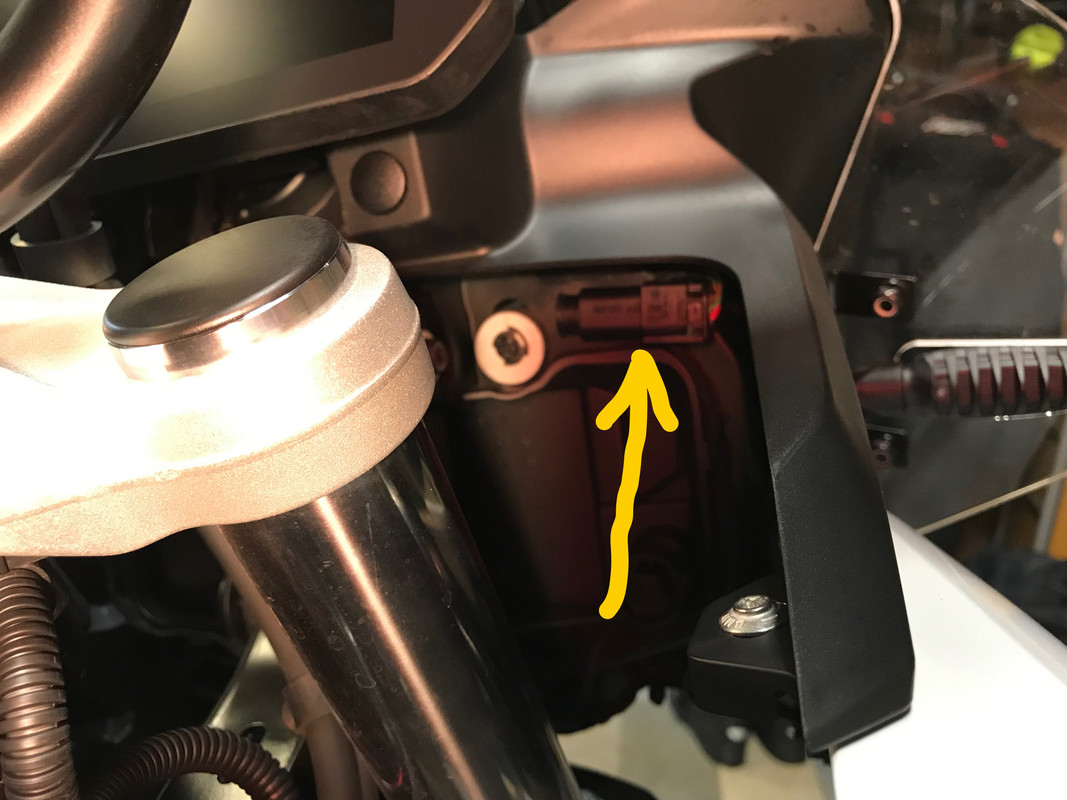

On the F750GS, where is the socket located - and what does it look like?

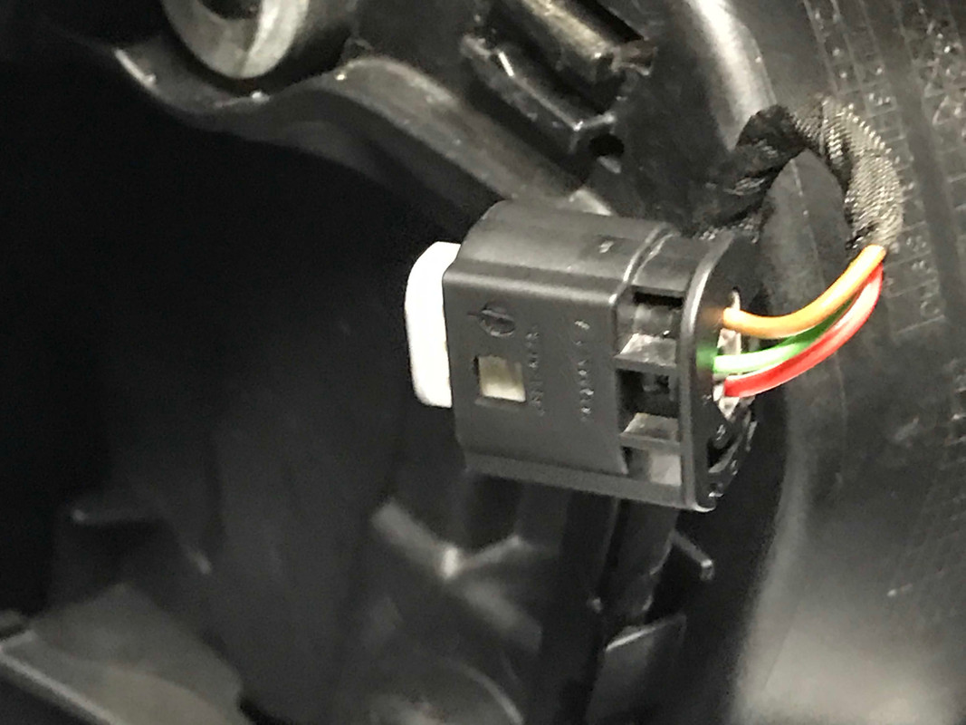

Hi Richard, my bike has the nav prep option so may be different but the cable from the nav mount runs up the headstock and joins a white connector under the screen and just inboard of the right indicator. This might be way you are looking for. Steve

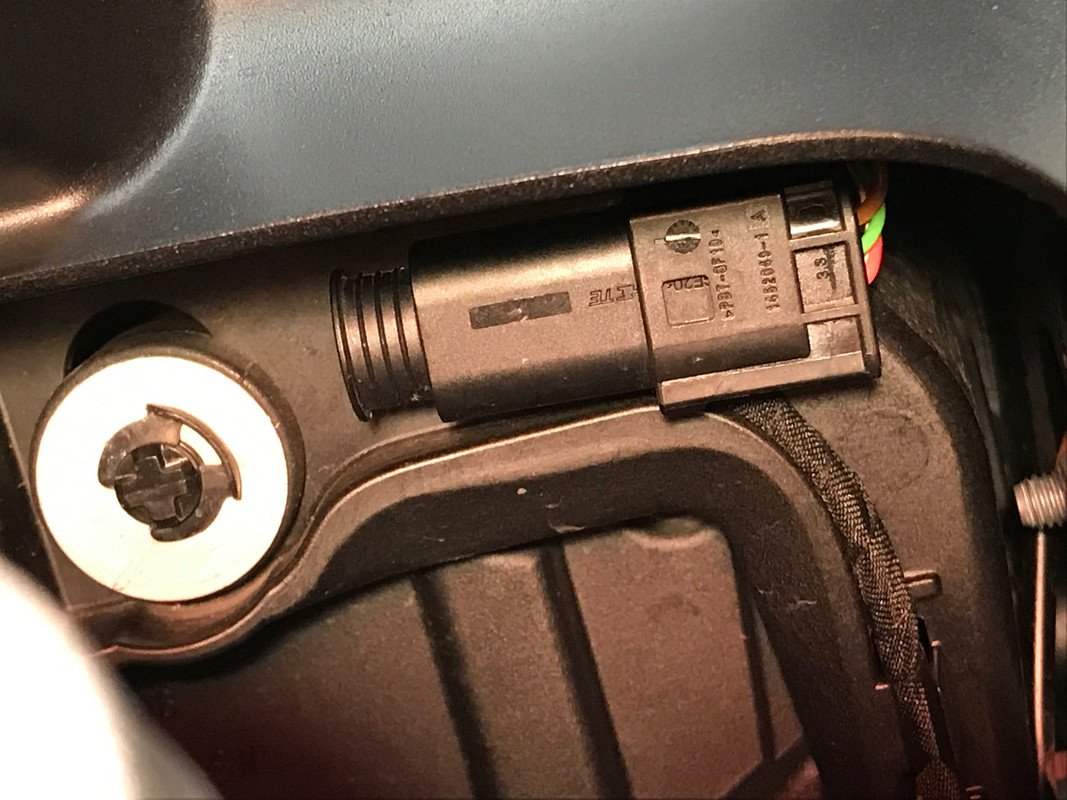

So, it's this one?
Looks like it - mine is white but the same shape and location but obviously with a lead connected.
Thanks again. I found a thread elsewhere (https://advrider.com/f/threads/f850gs-installing-garmin-montana-bmw-mount.1368996/) that explained how to remove a part of the cowling to really get at that connector.

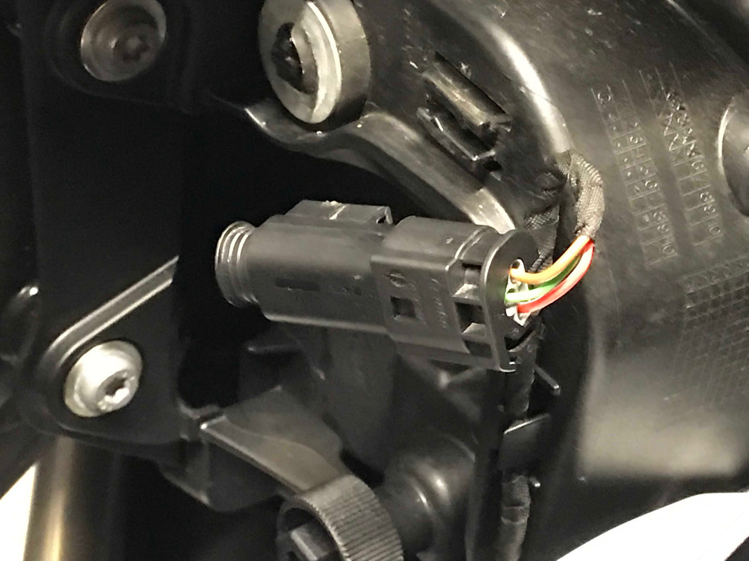

In case anyone else needs to see it in future, this is what the plug/socket looks like:
Obviously, in the first picture, there is a cap in the plug. This is removed and replaced with the connector shown at the top of this thread.
