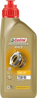

I Know, I know, Its an oil thread........
Looking to get away from the BMW oils.
Fully Synthetic 75W90 GL5 Castrol... All the specs are good?
This has changed from the Syntrax ?

As long as it matches the spec I’d say go for it
Mine used to get Motul Gear 300 LS, I changed it annually whilst I was doing the engine oil
Its more expensive than the OE BMW oil. And specs are higher. Its just the brand name ? Why change it ? Syntrax to Transmax . After some research, It does look like they have dropped that name. As its unavailable.

I did look at this. Meets all the specs, But why is it half the price of the Castrol ? Additives ? I see its GL5
I got 5 litres of Smith Allen gear oil for £28 of ebay for mine. I'll change it at the same time as the engine oil, should last me years.
