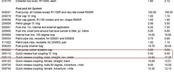

Anybody know off the top of their heads what size the 'O' ring in the quick-fit fuel connectors on an 1150 adv are?
And even better where to get them from - Motobins don't stock them.

Motorworks and James Sherlocks sell them.
Off top of my head one was much cheaper than the other.
You're not wrong £0.59 at Sherlocks or £1.79 + vat at Motobins, they were less than that at the BMW dealers in Spittal a D.:nenau
