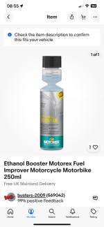

I try to avoid e10, and prefer e5 fuel when I can get it.
But I do use a fuel stabiliser when a bike is going to be unused for a couple of months or so- this one, and it seems to do it’s stuff.
