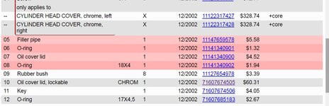

If all else fails, someone on the forum might have a spare tappet cover, they could send out to you!
Simon can you just wrap some duct tape tightly around the whole rocker cover like a bandage to keep it from popping up and down??? Enough so that it laps over itself by a few inches to provide grip despite the heat ??
I cannot understand what the Feck is going on with this! Never in 16 years specifically working on BMWs have I ever seen this!
Did you get the insert to set down into its seat in the rocker cover with the locating tab forward (If I recall ??)
Do you have a 2 O rings?? One on the insert and one on the filler plug??
Is the oil definitely coming out of the filler plug area?
Web address Linky https://www.realoem.com/bmw/enUS/sh...21-BMW-R_1150_GS_00_0415,0495_&diagId=11_2807
Attached images of the Link and part numbers 5 6 7 8 are the components you need
I wonder did they fit any O ring nearly the right size, as they did not have the parts in stock at that last service ?? I mean that is where you start having difficulties isn't it ??
I have seen the Sparkplug tube seal Part number 3 (also ringed) damaged by age or reassembly and the oil trails out the back of the head by the sparkplug cover (whether it be single or twin spark) and blows in the wind to cover your trouser leg and boot

Thanks again. Yes I have all the necessary o rings as per parts explosion.
And it is Definitely coming from there.
I am puzzled the seat was moving so much. Winding fine twine alongside the o ring stopped that movement....but potentially increased the oil leakage.
