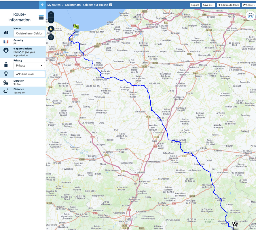

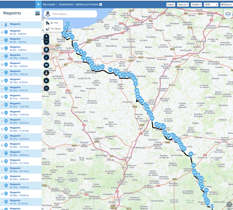

I'm about to start using MRA in anger. I've created the route below in Route lab, by giving it a start and an end point, but the route is obscured by the waypoint (which it inserted) labels.
Anyway to remove these labels so I can see the route?

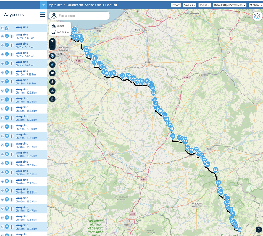

So If I reduce the waypoints, to say, 15, how do I compare the old route with the new one? Save it as a new route then use "add route"?
Aha, I see how so many came about. Thank you. MyRoute’s default position is to suggest a point evey 5 km or so, simply to help ensure a route is properly reproduced on a GPS device.
Yes, that’s the way I’d do it.
