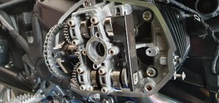

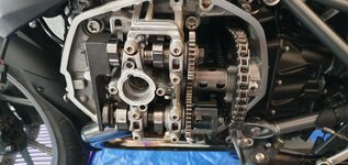

I just have to ask the question...
Showing the Cam Alignment Jig on the ends of the cams is for what purpose here???
The Cam Chain Tension Tool (83300444292) MUST be installed to properly tension the chain for the check with the alignment jig to mean anything.
In the top picture, the 17mm hex OEM oil pressure powered cam chain tensioner is seen just below the cam lobe closest to the chain drive sprocket...so the chain is in a slack condition and the alignment jig fitting on the ends of the cams does not show that the cams are in time...over the course of checking many bikes, if the cam alignment jig fits as in the pictures above, then when the chain tension tool, "292", is installed and tensioned to "3 clicks" it ALWAYS reveals that the cams are out of time and need to be moved.
Feel free to PM me so I can help you with this if you would like.
Sorry to be a "buttinsky" but it looked like you had confusion with the "B" end of the alternator rotor alignment use (or not to use it) and now the pics with only partial tools installed to properly put the valve train in position to check cam alignment.
Haha, the purpose of those pictures was to show Nutty the internals were not rusty. That is all.
Yes you are correct that these pictures are using only partly installed tools. The reason being I was curious to whether the Alignment Jig would fit straight away once TDC was reached.... and it did, on both sides.
However, as you rightly said, as soon as you apply the Cam Chain Tensioner Tool, without the Alignment jig in place, it will then not reseat correctly. So the cam bolts have to be slackened for the Alignment jig to be refitted.
Thank you for your comments, always question everything on here as mistakes do happen, but these pics were from curiosity and were not part of the Cam Alignment Job.
I just found it strange that the Alignment Jig fitted immediately TDC was reached without Tensioner Tool on both sides from new.
That is all.
