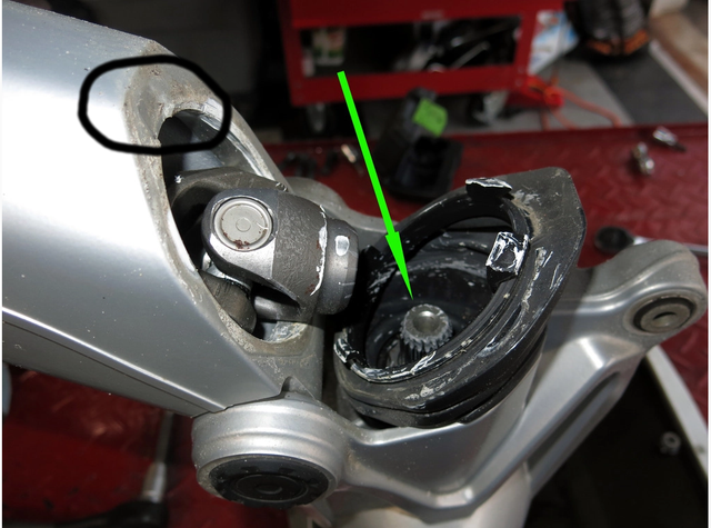

If I was a betting man, I reckon the little dent in the final drive that I have circled in black in the picture below, should be some sort of vent to relieve pressure, and not be full of grease, it is obviously there for some reason, as the black lugs go left and right of it.
If I was a betting man, I reckon the little dent in the final drive that I have circled in black in the picture below, should be some sort of vent to relieve pressure, and not be full of grease, it is obviously there for some reason, as the black lugs go left and right of it..
Yeah, that's there to let the water in :D
If you go by previous thoughts, that a thin bead of grease needs to be applied around the lip of the rubber boot... to allow water to run down that gully, then that little dent you've circled would still be redundant as it's on the outside of the seal. So it wouldn't vent anything.

Well here's an off the wall suggestion/observation, as the bike rides along with varying amounts of suspension travel I assume that the volume inside the swingarm is increasing/decreasing albeit slightly as the fd pivots up and down.
I would suggest a small hole in the bellows to test the theory (cheaper to replace than the swingarm casting if it doesn't work)
Me?, I'd be happy to pop a small clean hole into the lower part of the SA casting - but then my bike is an '05 with the SA on the original side.(And no rusty shaft IIRC)
Perhaps when they swapped sides they forgot to reposition the drain channel?

So I went into the garage today to check this rubber boot, and it was sucked hard onto the shaft. :blast
I got a flat head screwdriver and pulled back the rubber flap and pressed on the boot, where the notch is on the swingarm and.......
Swwwoooooooooooooooooshhhhhh
Air was sucked in, and the rubber boot inflated back to normal.
Must be a hell of a lot of pressure vacuum inside there :eek:
Anyways, that's how to release the pressure if you seal it all in :confused::rolleyes:
I'm a bit concerned of the impact this might be having on the final drive shaft seal?
