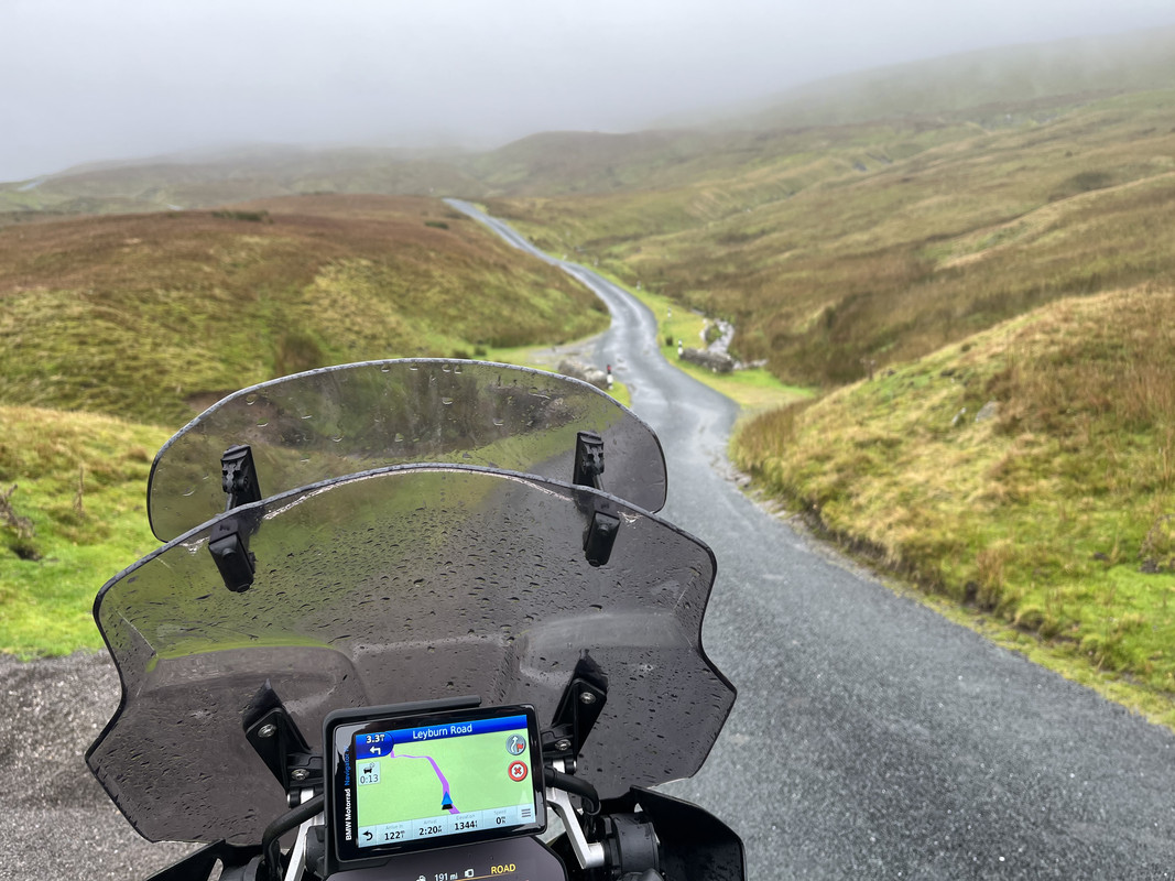

Puig Touring with factory fitted airfoil for me, work well but would recommend a strengthening bracket. I use a Cymarc one which works very well......
