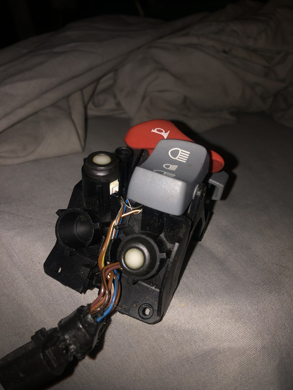

They fail. The lh combi switch failed on my 2011, at the same time I fitted a new led headlamp, I thought it was a faulty headlamp, until I swapped it back, I stripped and cleaned the micro switchs but to no avail
The only fix was a new switch unit at +£150 ( and that was trade+++)
