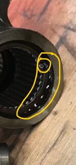

I think the side of the outer roller housing wears then the needle breaks out.
It can cause some hefty scoring on the support posts
I’ve given this more thought.
The roller breakout pictured is at the bottom bearing.
Because the thrust from the pushrod is from the bottom of the the rocker it’s always going to push the rocker up.
Hence the wear on the lower shoulder of the outer sleeve.
Rocker pushed up,needles squeezed down.

Yep that’s what I’ve read elsewhere. Both my R80 rebuild exhaust valve rocker lower bearing cages were cracked and valve guides worn at 45 k miles.

Definitely pays to check and reset rocker end float when doing valve clearance checks.
Helps to minimised the upward push thrust from the pushrods,wear on the rocker arm pads and debatably ,valve guide wear.
