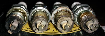

I have a 2005 R1200GS with about 31k on it that has developed a misfire in the last 100 miles. It manifests itself as an occasional misfire at idle (revs drop for a fraction of a second every 10 or so seconds) and a mild surging every few seconds while riding on a steady throttle. It's most pronounced on a steady throttle below 5000 rpm and happens in any gear. If I apply throttle the bike accelerates fine. It feels slightly lethargic at low throttle openings I guess but that might just be a trick of the mind. If I apply full throttle it takes off just fine. I have a full tank of fresh fuel and the problem started half way through the last tank of petrol and putting fresh in didn't change anything.
I've pulled the plugs and they look like this...
attachment.php
The plugs are from left to right... lower left, upper left, upper right, lower right. I've replaced these with new plugs and the problem is exactly the same.
Given that the misfire is fairly steady but intermittent and there doesn't seem to be a problem with getting fuel in and replacing the plugs didn't solve the issue my next thought is coils. This is obviously where it gets more expensive so thought I'd see if I was on the right track.
It looks to me that the bottom left plug is quite a bit blacker than the other plugs. The two centre plugs are identical and look fine and the lower plug on the right looks darker but also ok. The bottom left one is a bit sooty around the base which would be (in my opinion) in line with that plug misfiring over the last 100 miles.
If you agree that the next step is the coils I need to buy either just that one or all of them and either new or second hand. Are the coils the same for all years?

Swap the top (primary) coils left/right. See if the dirty spark plug moves. Ditto the plugs - one could be faulty.
