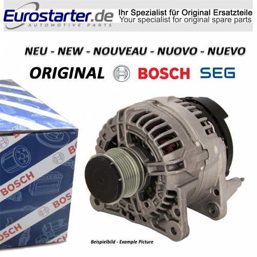

Any part no on em? anything else use the same one? looks fairly generic. 600 quid is ridiculous.
How about here…
no idea if they would fit….
