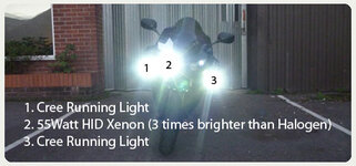

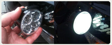

New LED Crees
Heres some great LED crees that will fit nice on a lighting bar! :thumb2
