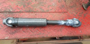

I stripped the swinging arm off eventually too replace the front bellows,
Which is a 20 minute job too do,
Support the swingarm at the brake end..
Exhaust off..shock lower bolt out,tie back out the way.undo the 3 small bolts on the S/arm Offside.

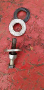

Big nut on the nearside,bolt out aswell,has the bearing insert attached
Return too the Offside and pull out,I didn't need the bearing puller either,just mole grips..on the centre bolt..
Remove/clean surfaces,/splines,Molyslip them,attach driveshaft,attach bellows after coating in Stubarags onto the swingarm.
Stubarags onto the gearbox end,feed the shaft into the tunnel,reconnect the bearing pins,
Work the bellows front end onto the gearbox,zip tie it..easy from then onwards too do the rear bit..
