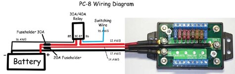

As a non-electrician let me ask a numpty question.
On the wiring diagram, I can see how the red switched positive activates the +ve bank of the connectors, whilst the -ve side is wired back to the battery.
That makes sense - I can see how the current wold flow through that set-up once the relay is activated, but what is the additional, non-switched second positive wire for (the 14AWG wire)?

Panasonic Relays spec sheets I've checked state operating current of 117mA to 168mA for different 12V automotive relays.
So the 16awg wire will handle it easily. Will the oem wiring on the brake light or parking light circuit cope with the extra? I'd think so.
But if concerned you could check the oem wiring spec and see what cable size is used there. Or if your headlight is always on you could tap into that as it will have a higher current capacity.
Maybe 16awg is recommended to minimise resistance/voltage drop in the switching circuit.
A you can use 1mm normal (14s wires) wire single wire which can take about 9 amps or if you prefer 1mm thin wall which is rated for 16.5 amps as a switching wire.
Take the switching feed from the front sidelight bulb. Remember it is only to power the relay not the fuse box.
As I see it from the left top,the 1st 6 are switched live via relay,
Last 2 are permanent fused live
Lower row is earth bus..
In answer to original question the blue wire could be fed from pretty much any ign switched feed ,side light,instrument light etc
Two of the terminals in the fusebox are wired as permenant lives, which is what the 14awg red wire is for. Ther rest are for the switched circuits.
You might want a non switched power supply for an aux socket,to charge stuff when stopped such as Bluetooth intercom etc
I’ve had the same module fitted to my 1200 since I bought it in 2009. I have a power socket connected to the non-switched side to defeat the canbus limitations. I use the tail light as a switch - I found that an easier cabling route than getting into the headlight unit. Satnav, heated gear etc is powered off the switched side.
