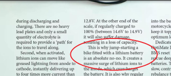

Im just converting to Lithium on the new 13. And it seems a minefield. However, the genuine BMW Lithium charger seems to be the solution. But now reading the above. My NOCO GB40 , which says is OK for lithium batteries, Apparently isn't ?
Is it ok for charging but not jumping?
Interesting article. didn't know you can't jump start a lithium Ion battery.
Not strictly true - I’ve jump started lithium batteries. I don’t know whether it reduced the life of the battery but it worked, and with electric start only bikes and you need to start it, there’s no other choice.

The whole point of the NOCO GB40 is to jump start the vehicle.
I get that, I too have a similar booster, mine can also be used as a charger.
Just looked at their web site and it states suitable for boosting 12 volt lead-acid batteries, no mention of lithium. Have I missed something?
It is however, a lithium booster.
