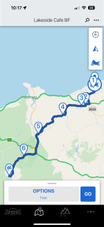

Hey Wapping
Complicated, bespoke routes can be created easily in the BMW Connectedride App, both on a iPhone or iPad. Not sure about Android devices, as I don’t own any. The process is identical on both devices and I find as accurate as creating in say MRA, just easier. You still have to zoom in on the roads you want to set the waypoint on, so as not to select the wrong carriageway for example.
And here is one to the same finish point, which I have just created on my iPad
The good thing about using the Connectedride app (may not be to your liking), is that the waypoints can be set randomly, and then app will work out the order. This means if i want to place a waypoint between say 3 and 4, I don’t have to reorder them like you do in MRA.
This is what the app looks like on my iPad screen
In respect to registering the iPad to the bike, I simply downloaded the app to my iPad, logged in using my normal BMW id (same for bike and car) and it all syncs.
