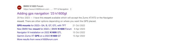

As ever, Google is your friend:
The bloke witters on but you might get some ideas.

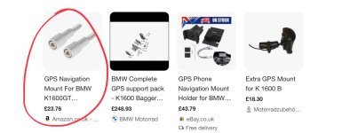

I have mounted my XT1 on a steering stem mount, which works very well. I also have the option of a phone mount, using one of these (or similar) circled in red.
