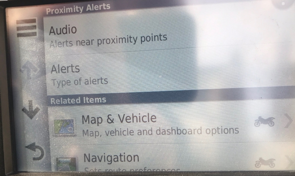

If I upload the 3rd party ones, how does it notify you of them as you approach them?
You get the same warning but you need to tick the other box under the warning options
Thanks for that, I assume that comes up when you install them? Seems bizarre I have this and the BMW TFT connect app and they are both out performed by my wife’s ( my old!) Nav 5 !
It should be simiar to the nav V
Proximity Alerts
Alerts
Custom POI
