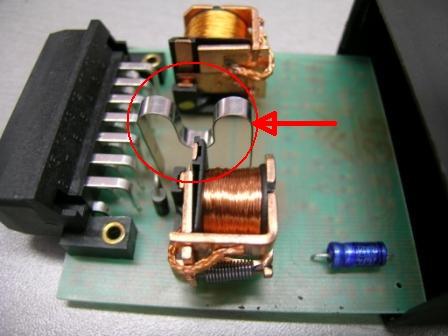

A while ago, a guy on the 2v-GS forum in Germany posted a diy solution:
Open up the relay
The M-form bridge, (circled in red) must be removed - if you can unsolder it, you can replace it if you want to backout - or you simply snip it off.
Then, solder a 1.2 ohms a resistance across (at least 2 W).
Youre finished.

Hmmmm, interesting....have you got a link to the original German post?
I'd like to know if this mod actually saves some power, or is simply using the resistor to fool the relay?
Open up the relay
Youre finished.

Vielen Dank John! :D
The mod is for '91-on airheads with left & right indicator switches on the handlebars and cuts-out the fast blinking circuit (when less load is detected, i.e broken bulb) - I did think the flasher looked a bit funny...thought I only have a 'simple' square box with 3 contacts in my old ST.
