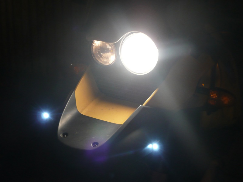

With an HID low beam and the OEM filament sidelight bulb, you get a nice 6K colour on one side (depending on what colour HID you went for, obviously) but a old fashioned feeling yellow colour sidelight.
So for a very little money, I changed my sidelight bulb with a 6k superbright LED, and this is what you get (my bike tonight)
MUCH better :thumb2

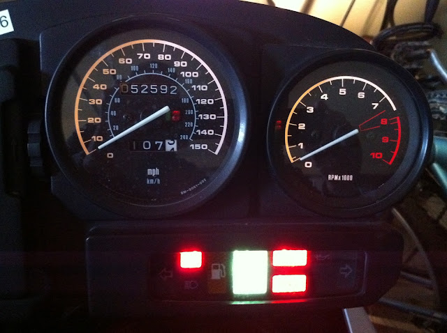

Then there's the dash illumination......again, not my bike in this one, but the tacho and speedo bulbs are that old yellow incandescent colour
So I've replaced the speedo bulbs with a pair of 6k leds, and on the tacho , one 6K led on the left side of the dial and a red on the right, which works well IMO, showing up the redline area nicely :)
My bike tonight:

EDIT......the sidelight (pilot) bulb is a beeyatch to get to from under the instruments, so I went in via the screen and binnacle cover.
I tidied up the cover while it was off :)

DASH LEDS (red and white6k)
You need a total of 4 bulbs for the speedo/tacho.....
Pilot light
:thumb2
The little T5 type leds, like the bulbs, can be a bit fiddly......the bulb holders they go into have a rubber cover on them, and I found that when i put the bulb in, it worked initially, but when squeezing the rubber holder which acts as a grommet as well back in, the bulbs would go out 50% of the time......the T5 design has two metal prongs that stick out, so the solution I found (and they're still working after a few miles) was to simply pluck the prongs out a few MM to give them a bit of spring action against the holder, then they make proper contact and survive the action of the assembly being pushed back into place :)
The Pilot bulb (type 233) is a standard capped bulb, but unlike the filament incandescent bulbs, LEDs have to be the right way around, so if you plonk it in and it doesn't work (no harm done) just pull it, rotate 180 degrees and pop it back in :thumb2
I sorted my speedo and tacho bulbs recently. But unlike Fanum, I bent inward the contact tangs in the bulb holder (I didn't trust the tangs on the bulb to stay in one piece, I also feared it was forcing then into more of a barb shape...). Something else I did was to smear a little silicone grease onto the rubber surround of the holder to aid insertion, you know what I mean, it all just seems to pop in without any fuss ; -)
And thanks to a steer from here, I bought new led bulbs that seem much better (not brighter, but more robust). If i can dig out the link I'll post it.
All that was a couple of months ago and so far so good.
Sent from my SM-N910F using Tapatalk
When I used that type of bulb I found they stopped working after a while. The contact wires were just not springy enough. A blob of solder on each wire fattened it up enough to solve the contact problem.
