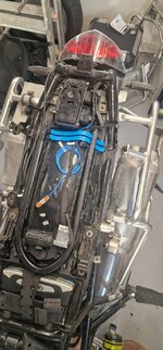

Ok. Found a shot. As I thought, nothing else under the seat cowl except the alarm unit - unless the tpms receiver module is included in there, it must be somewhere else on my bike?
Blue straps are just to gently keep the cables from fouling the U lock

Alarm unit talks to the wheel sensors, it also has two CR123A Lithium cells inside it that need replacing at roughly five yearly intervals.
I changed them recently, when I fitted the PDM unit (thought I'd do it while I was there)
It’s the alarm unit.
Does both.
That is interesting! thanks!
Looks like I'll have to get that cowling off again 🤬

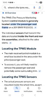

There might a connection to my current problem or it's something else going wrong! But the front is vulnerable to water spray and the sensor being lost due to a bump up the kerb may point to something up with that front circuit or it's all just a red herring. Either way I have to check. The immobiliser is one of the things listed when the virtual fuse came in (see pic attached) so just maybe the is a connection 🤷🏻

Just a thought, but I have a suspicion the Canbus might need a 'terminator' in the wiring to the alarm such as a resistor with a known value or similar, unless the alarm unit has one built in (seeing as it is the last item on the wiring loom)?
Might be worth checking this out, though I haven't owned a Hexhead for a while now and may be talking compete bollocks.
I have a 09 GS with 90k on the clock it has TPMS and I have never replaced any batteries.
In the sensors, maybe... But I can't see the alarm batteries lasting so long, I mean if you actually use the alarm...
My bike doesn't have an alarm so no batteries to replace. But the TPMS module is in the same housing as the alarm would be.
there is a budget TPMS only box and that needs the canbus termination thing (not expensive), if you fit the alarm, both the old simple box and canbus terminator come off the bike - all mounted in the same place above the rear wheel
BMW shipped a lot of bikes with the RDC present in the same enclosure as the DWA even if the bike was specified with only the DWA option. In that case the RDC can be activated using the Motoscan app (and perhaps the GS-911).
