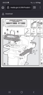

They did 2 versions of the support brackets that the monokey plate sits on. I have the original one in a box somewhere in case I get yet another R1150GS one day. The later version was more substantial but uglier. I think it also raised the topbox up as well. The photo below shows the original version that is not available new anymore.

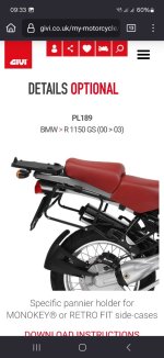

The second image shows a diagram of the later version which appears to still be available. I ordered this one a few years ago but I sent it back as I didn't like the look and it was very heavy.
If you do decide to get one any UK Givi dealer should be able to order it. Part number is SR694 according to those fitting instructions.
Many thanks everyone for this input. Someone else sent me that 2nd image via e-mail, and yes you're right Mike, it does look heavy and cumbersome (and at a funny angle too).
I did have a Givi 52 litre box years ago but sold it including the base AND a metal plate that fitted to the rear rack below the black plastic mount. I appreciate it would be more reassuring having support mounts as I've seen a broken rear rack (not pretty). The 1st image shows quite a flush and level mount which almost looks OE on the 1150. Wish I could get the dimensions of the plate to get a copy made. Oh well, the search goes on.

You are right, it had a metal plate and small metal support arms. I have dug mine out. See the photo. I would not use just that universal plastic mounting plate without any metal support parts.

The more modern kit ( in the previous post) from Givi that raises the carrier is not the kit they used to sell when the 1100/1150's were current models .
The old kit just consisted of the lower strengthening arms and bolts and then you used the flat universal monokey or monolock mounting plate
I put the newer style strengthening kit on my 1150gs (it was secondhand and included the Black M5 monokey plate which does not suit the bike, kept the strengthening bars and the the steel riser plate but have bought a cheap M8A alloy plate from Louis and it has the same mounting point as the M5 so bolts on .
Suits the styling on the bike and keeps the top box a little bit lower
