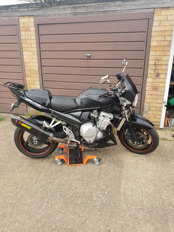

I use one of these,pictured with my GSX1250,moved my RT1200 without issue.You will need a good even surface.
