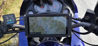

Enter the Nexus 7
7” of pixel heaven and with an overall size of 190mm x 120mm its overall size meant it could sit in the area of the low screen above the Kombi and still give me a clear view of the road ahead
A quick search of the web showed it had been done before, so it was a viable option.
So what did I have and what did need –
I had Nexus 7 32GB wifi model running Jelly bean
A GSA nav bar
A short Ram arm
A Ram plate & ball
What did I need?
A mount for the Nexus
Bar mount to lift the Nexus up and away from the Kombi
A waterproof case for the Nexus
Ebay came up with the goods and I ended up with a case & mount and a bar mount
So plastic flashed and posty on his way the parts arrived
Bar mount self explanatory,
Case and mount, not good, the case was good, however the mount was useless.
The nexus flopped round like it was on a jelly … so I was going to have to go to work
Removing the original mount on the back of the case was easy, I just cut the liner in
The back of the case and unscrewed the mount.
The holes / mounting posts didn’t fit to the Ram ball, but 5 minutes with a drill and Stanley knife rectified that.
Fitment to the Nexus was good, the case comes with 3 thickness if neoprene shims to stop the unit from moving, I used all 3 it keeps the Nexus pressed against the plastic case
So now I have a case with ram ball on the back coupled to a short arm
One bank holiday weekend later and I have a bar mount
Fitting was straight forward, I slid the Nav IV mount to the left and bolted the bar mount in and angles everything to an approximate position.
It’s WIP at the moment so needs final tweaks
Now the fun starts –
Rigidity and flexibility.
There is some vibration seen in the unit, this I think is due to the small mount plate coupled with the physical overhang of the unit. It’s not a problem but could be better if I wanted to be a perfectionist.
Doing a search of the web I came across a Brodit powered mount, heaven!
For those who don’t know Brodit, they are the equivalent of Ram for automotive mounts of phones & navs.
Believe me, if you have a Brodit mount in your car its tailor made to the panel / it’s mounted to, and it wont move, ever.
The downside – not cheap near on £90 for a new unit
The bay had some cheaper used stuff, so there on watch at the moment.
The other option is an ally plate bolted inside to give some rigidity
But that’s for later … So we have a display, mount, and power, albeit internal, but that’s another topic to address

This is where the fun starts; the nexus runs droid, so the play store was the place to start
I looked at free stuff first, and there’s plenty of it. And plenty of shite too.
Shonky front ends and linking apps are not sat navs lol
After an evening of downloading, installing, configuring, and uninstalling lol I’d narrowed it down a bit.So the arsenal consisted of
Co pilot
Tom Tom go
Igo
Navigator
Navrut moto
Here wego
Navion
Navfree
Maps me
Kurviger
There were loads more, but they either didn’t work with the nexus, or they required a data plan, and the nexus I have doesn’t have a sim card option
So that kissed goodbye to Android Auto & Waze

Right,
with all this free time, i thought it may be time to revisit this thread
Since the last trip & the power failures, i have cahnged the bike so the power socket is by the kombi,
I procured a Nexus 7 with 3G, so was going to have a play with that, unfortunatly the unit i bought, had allready had a
replacement screen, which ulitimatly failed ...
I have a another unit as backup, so planned to swap the screens over. -- it's doable, but some of the internal mounts
need trimming as the inner bezel is different. I also spotted on ADV that an otterbox case is easier to mount.
I found an auction with a nexus 7 & otterbox case, (peanuts) it should be here next week
Also the Galaxy tab active was mentioned as its already ruggedised, & IP67 ready out of the box
Downside is it needs a mount, Brodit do them, but they aint cheap lol
I'll use this as a future project ( i need a new tablet anyway) (it should be with me next week)
Now i know the Nexus works, as i used it on the Dent trip outwards so i've ordered a usb power monitor, and I'll give it

I made a mount to use a 6.9" phone is a Garmin Montana/AMPS mount So i can switch between the 2
Works very well with OS maps
Far better than any Garmin GPS with raster maps
Pleny bright enough ( the pic was taken in bright sunlight )

Did you make the back mount yourself?
If so you may have people asking you to make them one - the oem one is uber expensive :)
Plus, you can watch downloaded movies while you ride! :D
Joking of course, but it may occur to cops you pass?
