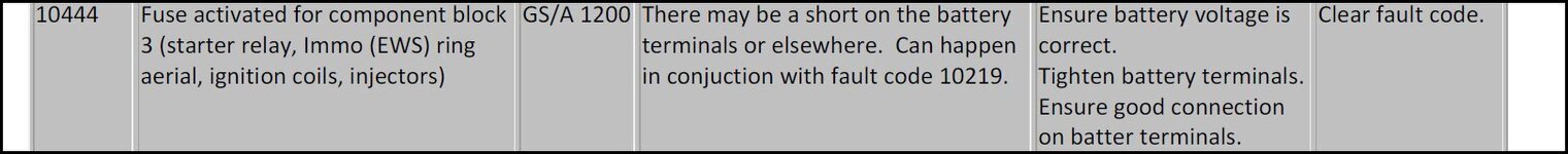

Further update.
I'm now in. After lunch
Persuaded them to let me use their garage space so I can look into the alarm, physically eyeball the plug.
Before that. I've just plugged in the GS911. Screenshots below.
I've ringed the one meaningful faults that's present. The other is just the exhaust flappy valve.
So... Can anyone interpret this?

And here's the pic
Sent from my SM-S908B using Tapatalk
Hope it helps.

This is what came up from a Google search of the fault code. I assume you’ve already done this.IMG_1958.jpg
