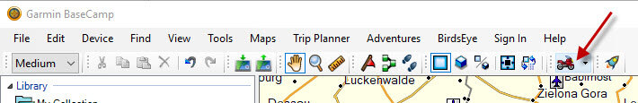

look at the route settings and ensure it is not set to direct. it will be where the arrow is pointing.

Thanks for the replies. I've got "Driving" set as route activity profile. The old PC is at my old place of work so I can't copy the maps over.
