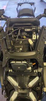

Needed to remove screen, winglets, deflectors, nav bar mount, front beak, radar cover
Had removed all the above bits before on jobs, except the bar mount and the radar cover
Bar mount, 2 bolts at the top
Radar cover, 2 spring type clips at the bottom. Always stressful that you are applying too much pressure, but they do pop out. BMW instructions show where to apply the pressure
If you have the electric screen you will have to have it at the uppermost position
If you have the rally version, instructions show removal of the RH indicator

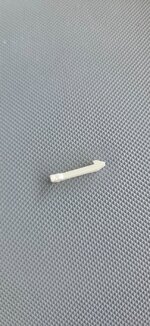

The evil connector
The above is the one on the old unit. There is a central piece that slides into a fixed holder with a spear like head that needs moving over to the side and a clip to the side that needs releasing which handily is underneath. I couldn't get the connector to slide out of the holder and broke the spear thing off. It still works, still slides on, so replacing the old holder won't cause an issue

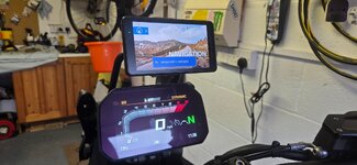

End result....looks better

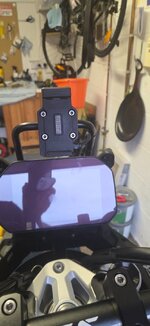

Can't use my Wunderlich sun shade as it covers the release button at the bottom of the mount
Final test

Mine came with this new nav mount. I also have the Wunderlich sun shade on the speedo. As a result, it's too tight to get a finger in to the release button. I find the release can be activated using the bike's key, which is long enough and slim enough.
