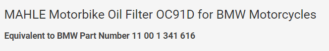

I'm newish here too
I've googled and searched before getting ridiculed for asking a "silly" question.
seems to me the most popular way of thinking
20/50 mineral oil in engine
GL5 in the diff
80/90 gear oil in the gearbox
all supposed to be 12000 miles interval but its all cheap stuff so every 6000 ish would be nice
mahle seem to make the oem stuff for bmw and is a fraction the cost
air filter is LX578
oil filter is:
