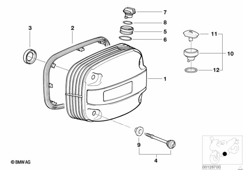

Pieter , had same problem recently
Ordered this and replaced it all…sorted..
Easy to remove and if you worried anything falling into the cylinder head, just take it off…
You can obviously order seals only but I reckon the plastic start getting more brittle over time, after all 20 yrs +

Good shout, ordered one as I have the same problem. (y)
Cheera all thats spot on advice, and great link for the small price ill grab the kit i got a few bits i been meaning to order from motorworks anyway so thats great, yeah mines 30 years old but she is going strong so want to keep any minor leaks at bay 👍
ordered all that, but i was trying to get the lower piece out of the head, does it just pry up? was getting a screwdriver in there did'nt seem to want to shift? cheers
I used a hook like tool and had it out in no time……it has got a rubber seal ring and I assume that could be backed in ….
Maybe just take the cyclinderhead cover off, gives you better access and you could even drive it out with an appropriate tool…
It just levers out. Use a screwdriver.
Cheers steptoe, ill give it some welly next time im in there 👍
When replacing use a new sealing/ O ring with a smear of sealant around the cap holder before putting on the O ring, then a smear around the outside of the Obribg, then use a suitable sized socket and knock the cap holder in place.
Leave it for 20 minutes and let it set before starting the engine
