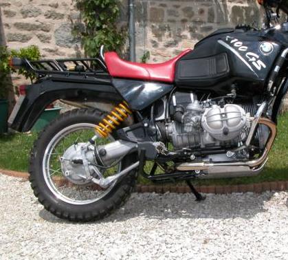

If you look at this:
You can see that as standard, even with an Ohlins, the drive is canted up a little. A shorter arm would bring it in line and raise the back a bit.
