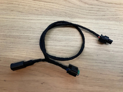

NN sells a cable adapter/ splitter that is designed for this purpose. It connects inline with the feed to the aux socket. My bike has an OEM factory fitted usb on the dashboard and I run two led lights via the NN splitter.
You could also use it on the aux socket under the pillion seat if you don’t have the usb on the dash ( fitted on later models I think) although it would involve more time running cables through to the front.
One small issue is that the canbus trips out (with the same symptoms you’ve described) if I try to run the lights at the same time as the usb for phone charging. The lights have a switch so I turn them off if my phone is charging. I felt the benefits of being ignition controlled and canbus ‘fused’ outweighed this drawback….and I already had the lead on the shelf.
I think bmw can also supply an oem version of the splitter.
